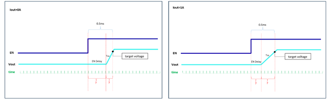

I am reviewing the datasheet of the TPS566238, and I have three questions about the POWER START UP time.
 TPS56623x 3-V to 18-V Input, 6-A Synchronous Step-Down Voltage Regulator datasheet (Rev. B)
Question 1

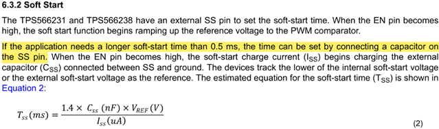

In Section6.3.2 Soft Start,
it states that "If the application needs a longer soft-start time than 0.5 ms, the time can be set by connecting a capacitor on
the SS pin" indicate that the calculation method for Tss is 0.5ms plus the value calculated by Equation 2?
Question 2
Is there a minimum capacity requirement for Css when I want to calculate the minimum time of Tss?
Question 3

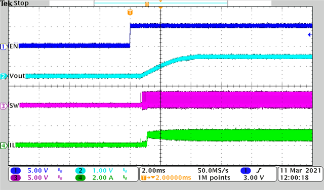

I have not found any description of the Enable delay time, except in Figure 7-15. Start-Up Through EN.
It shows approximately 0.2ms. Is it a typical value?
Thanks and Best Regards
