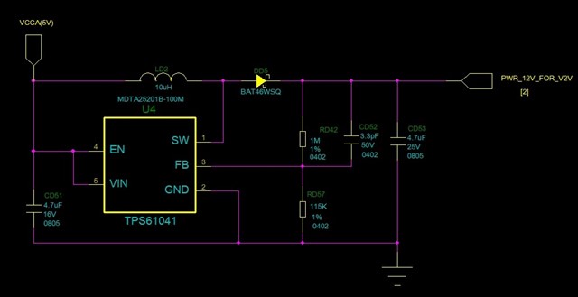

Hi team,
The customer is going to use TPS61041-Q1 to build a 5V to 12V circuit with a maximum load current of 40mA. The schematic is as follows. Please help review it.
Thank you!
