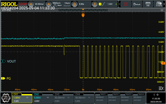

当U1001负载出现电流突变时,U1004的输出会出现异常,请问这是什么原因,尝试过降限流取消,仍无法解决问题

    I am using translate app to read this.
    You mentioned that when there is current surge at U1001, U1004 is also getting affected and has abnormal output. Can you describe more on what do you mean by abnormal output and how big is the current surge at U1001 and is it due to input supply or output load.
    Any waveforms?
    Arush
  • hi Arush,
    There were some problems with my description before.
    When there is current surge at the 12V_NX netlist, then the U1001 will be malfunctioning. The waveform is as follows. But when I use wires to replace the CM1000, the U1001 will work normal. In another method, I use a wire to connect the input and output of U1004, the U1001 will also work normal. The load current of U1004 is very low.
