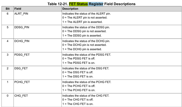

see below the FET status register :

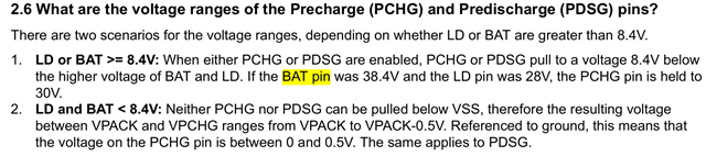

    According to this paragraph in the document Frequently_asked_question_BQ76952.pdf :
    I should get a voltage on PCHG/PDSG of BAT_pin - 8.4V, which in my case is 12V-8.4V. However, the voltage I get is VC16 (35V) - 8.4V = 28V.

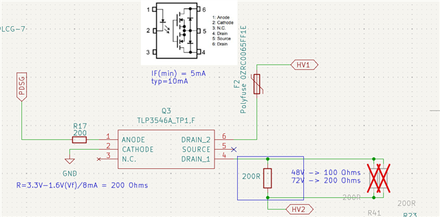

    I thought that the PDSG pin, when active, would have an output of 3.3V. So, i nstead of a P-MOSFET, I was thinking of using a TLP3546A optocoupler like the schematic below.
    However, it seems that this is incorrect? The output on PCHG/PDSG pin when active is HV - 8.4V? In my case, that's 36V-8.4V = 27.6V. Please correct me if I'm wrong.

    The BAT pin is used for the CP1/CHG/DSG pins to dictate the voltage level of those outputs. For instance when enabled CHG = CP1 = BAT+11V, when disabled CHG=BAT. This is because the source of the CHG FET is should be BAT (top of battery stack). When you have a fixed 12V at BAT_pin, but the CHG/DSG FETs are seeing 36V, they will not be correctly overdriven to 36V + 11V= 47V (if using NFETs), as they should be. Instead they are outputting 23V = 12V+11V, which is incorrect when the sources are at 36V.
    The PDSG/PCHG driver is design to driver a PFET device and  operates by pulling the pin voltage slightly lower to enable the PFET. Therefore the active voltage level is 8.4V below whichever is higher (BAT vs LD pin). Since it does not require the Charge-Pump it uses a diode OR for the highest voltage. When in-active (disabled) the PCHG/PDSG pins are Hi-Z and therefore floating. If there is no pull-up resistor on the pin, this may explain why you are seeing ~1.3V when disabled, which is likely where the leakage between the PDSG pin and the optocoupler equalize.
    The PDSG pin cannot be programmed to output 3.3V, it will always be MAX(BAT,LD) - 8.4V when enabled, or floating when disabled.
    However the DDSG/DCHG pins can be programmed to a specific IO voltage (1.8V, 3.3V, or 5V). Although they do not include the Predischarge Timeout and Predischarge Stop Delta Settings you are interested in. They instead will follow the same logic as CHG/DSG pins.
