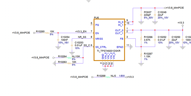

Hi team,
Could you please help to review the schematic of TPS7A9201?
3.8V to 3.3V,
BRs,
Rannie
Hello Rannie,
The schematic looks good but I need to know what is the expected continuous load current and the max or peak current?
Daniel
Hello Rannie,
The power dissipation is low and the risk of thermal shutdown is very low.
