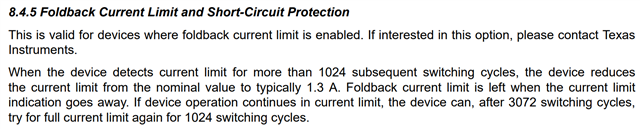

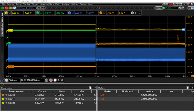

We test the short circuit protection on TPS628502. in datasheet, it says that we will limit the current to 1.3A. But in our test, we saw 3A here. Do you have comment?

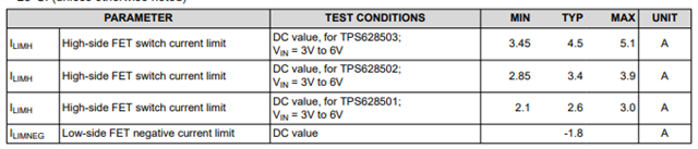

The foldback current limit is a special feature and the device needs to be specially programmed for this. This version is not released.
The device versions RTM'd have a normal current limit according to the table below.
