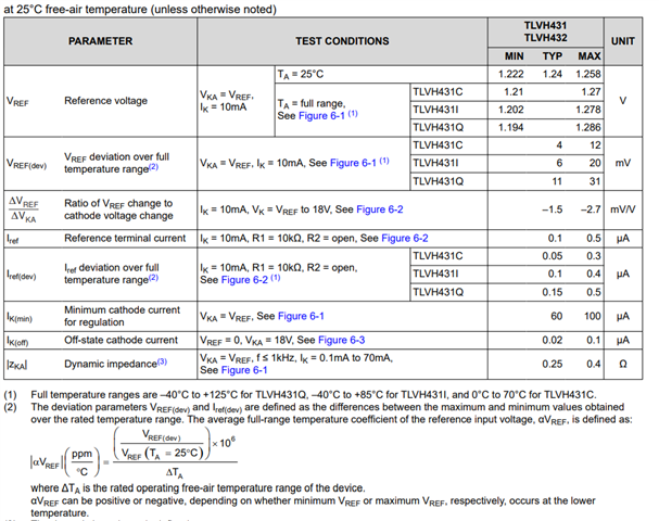

  1. Temperature Characteristics
    Could you please confirm whether there is any internal data available that shows the worst-case temperature coefficient (e.g., MAX ±〇ppm/℃) for TLVH432QPK?

  • Hi Teritama,
    1. We do not have any data beyond what is given in the datasheet. For temperature, we provide details in section 5.5 of the datasheet, and plots are available in section 5.8
