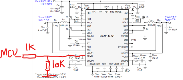

Hi team,
My customer wants to control the DEMB pin by MCU GPIO. They need to use different modes when in different scenarios.
They use a 1K ohm pull-up resistor and 10K ohm pull-down resistor. Is it feasible?
