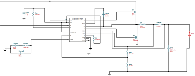

LM25139-Q1: Vout worst case analysis
Part Number: LM25139-Q1
Hi E2E teacher,
How to do LM25139QRGTRQ1 Vout worst case analysis? And any other worst case analysis to be recommended?

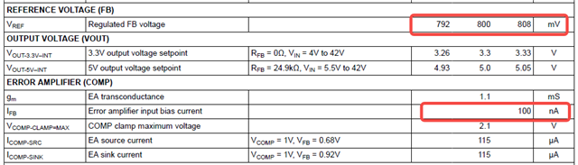

What factors should to be considered in calculate? such as Error OA Voffset, Ioffset? but they can't be found in datasheet?
As below Vfb/Ifb considered Vin/Iout and other factors?
