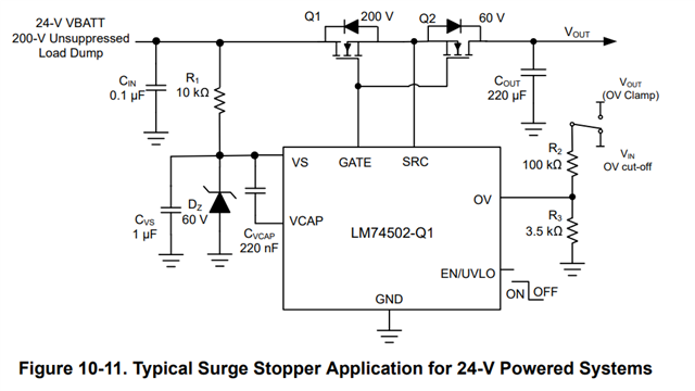

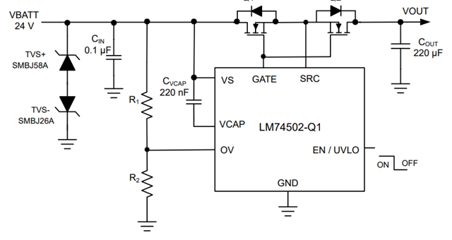

Dear Team,
  LM74501-Q1 may used without TVS.
may LM74502-Q1 use without TVS, the datasheet have two circuit.
may LM74502-Q1 use without TVS for 48 volt systems?
Do you suggest use TVS or it is not neccessary
