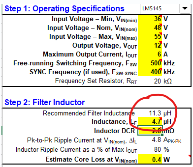

Hi Team
my customer have below application and they want to use our LV5144.
TI PN
Vin
Vout
Iout
Output ripple spec
Output spec based on transient current
(0%~70% and 30%~100%)
LV5144
24 or 48
12V
6A
120mV
+-5%
But I find inductor value is larger for 48V vin and 6A output
do you think I need to adjust Fsw for lower/make sense inductor value or the value is ok for me?
LV5144_quickstart_calculator_A5.xlsm
BRs
Brian
