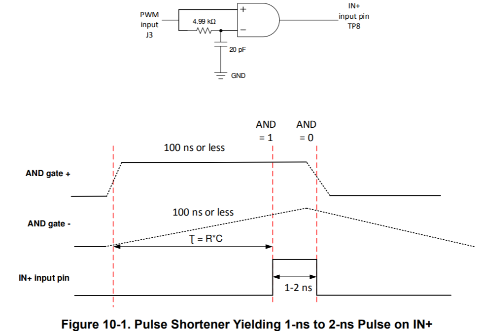

We use LMG1020EVM-006. This image is quoted from the EVM User's Guide: LMG1020EVM-006.We are adjusting the frequency of the function generator to achieve the narrowest possible pulse width (1 ns) at the output.
I would like to increase the output signal amplitude of the AND gate SN74LVC1G08 used in the LMG1020EVM-006 evaluation board.
The reason is that when trying to generate narrower pulses from the SN74LVC1G08, we found that the signal amplitude decreases.
How can we maintain the output amplitude while still generating narrow pulses from the SN74LVC1G08?

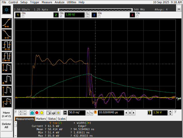

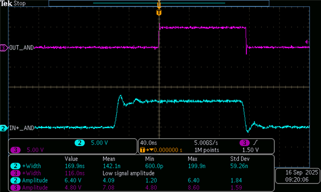

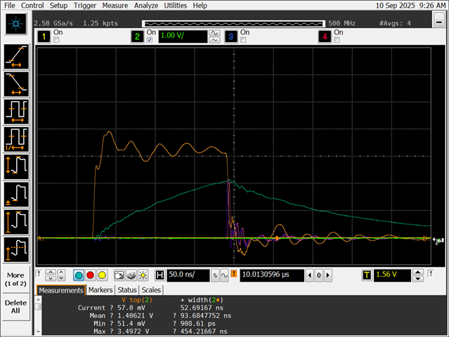

    For comparison, I upload the waveform when the pulse width is adjusted to 2 ns (left) and when it is adjusted to 7 ns (right). The pink waveform represents the output from the driver, but at 2 ns the amplitude is lower. I would like to make this amplitude about the same as it is at 7 ns. I would greatly appreciate your advice!
    IN+ to the AND gate: orange
    IN- to the AND gate: dark green
    output  of the AND gate: purple
    output of the driver: pink
    [pulse width:2ns]                                                                        [pulse width:7ns]
    Makiko

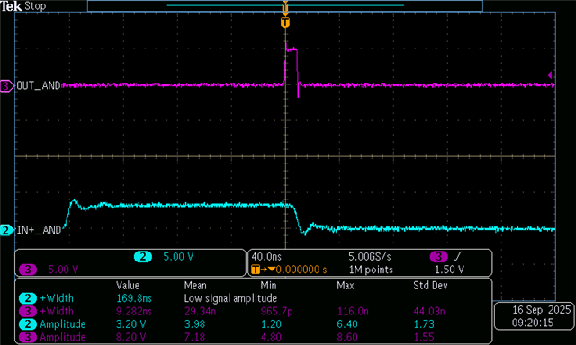

  • Hi Makiko,
    Looking at the EVM user guide, the pulse width into IN+ of the AND gate should start at 100ns and slowly decrease until you get to the desired pulse width. Your waveforms seem to have the same 170ns pulse width for IN+ of the AND gate, but somehow you produced both a 7ns pulse and a 2ns pulse with it.
    When I recreated your setup, I did not see this same issue. I was able to achieve a 1ns pulse from the AND gate that reached 6V.

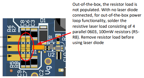

    You can find the EVM user guide here. I would recommend removing the laser diode and following these steps to correctly size the pulse width using a resistive load before adding the diode. I followed these steps based on the EVM user guide once taking the EVM out of the box. You said you had made no changes to the EVM besides adding the laser diode, so you should be able to do so even though you have used the EVM already. Quoted portions below are taken directly from the user manual.
    1. Check the effective resistance of your laser diode so you can effectively recreate it. "When selecting a resistor load, use 4 parallel 0603 size, 100 mW resistors and a typical laser diode resistance value of 1 Ω to 20 Ω. To achieve nanosecond pulses, a 1 Ω resistor load is recommended, in which four 4 Ω parallel resistors for R5 - R8 would be needed." I used four 4Ohm resistors.
    2. "Start by testing the EVM without a bus voltage to achieve the required pulse width, frequency, and repetition rate on the gate test point, Vg (TP4)." The conditions should be as follows below:
    - J1's DC bias supply should be at least 5.5 V, with current limited to 100mA.
    - Function generator should be set at 0-3V, 100kHz, 100ns pulse width (I ended up increasing the input level from your setting of 0-3.3V because the SN74LVC1G08's high-level input voltage threshold at 5.5V is 3.85V, so you may have to do the same)

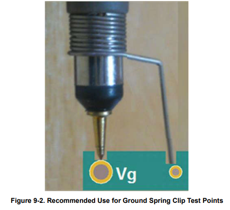

    3.  "When first starting to fine tune the function generator input to see the pulse on IN+, start with 100 ns then reduce the pulse width down by the nanosecond or smaller to make 1-2 ns visible on the IN+ test point." Please use tip and barrel to measure the IN+ and Vg test points (as shown below)
    4. Take the resistors, R5-R8, off before populating the laser diode
    Once you have tried this, please let me know if you are still experiencing this issue on the output of the AND gate.
    Annabelle

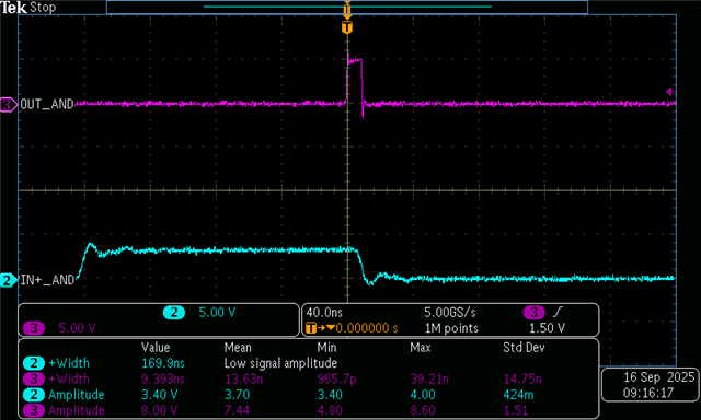

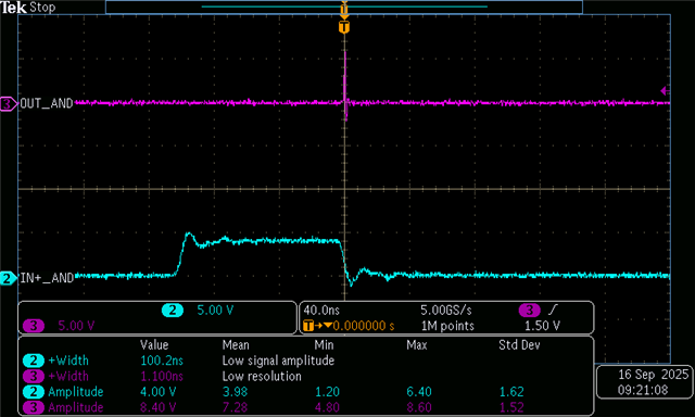

  • Hi Makiko,
    The model name is Tektronix AFG3102C.
    For the output impedance, it was set to 50Ohm when I got the normal results. When I changed the setting to high impedance, I was not able to get a nanosecond pulse. Please see the images and conditions below:
    50Ohm, FG set at high of 2.2V, pulse width of 100ns: 1ns pulse
    50Ohm, FG set at high of 1.65V, pulse width of 170ns: 9ns pulse
    50Ohm, FG set at high of 3.3V, pulse width of 170ns: 116ns pulse
    High Z, FG set at high of 3.3V, pulse width of 170ns: 9ns pulse
    High Z, FG set at high of 3.3V, pulse width of 100ns: no pulse
    Annabelle
