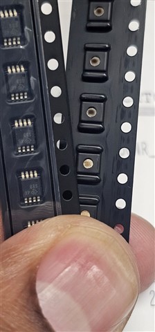

Please verify for TPS7A4101DGNR the reported EXPOSED THERMAL PAD oxidation if any concern to further use.
All our remining stock is verified to have the same condition.
Per customer all 24 pcs are looks oxidized. Is this defective? Please
refer email and advise this is defective or not. Replacement is required.

    Could you please help confirm if this only happens to one reel or multiple reels? Do you happen to have a lot# ?

  • Hey Manuel- I am checking this with A/T site but could you confirm all the material listed in the table also have oxidation issues? Or only the 24 PCs?

  • Hey Manuel-
    I have been discussing this with A/T site and here are some questions/ feedback:
    1. For the 24 PCs showing oxidation, did customer only find 24 PCs showing discoloration from one reel or you only received 24 PCs?
    2. Were the other batches customer received earlier partial reels they kept in the storage room?
    3. Did the oxidation only happen on the open pocket hole, any other oxidation observed on the lead or other area on the power pad?
    From A/T's experience, they suspected this is related to the customer's environment, but you can contact local FQE and return the affected material to investigate further if needed.
    Su
  • Dear Su,
    Thanks for the coordination.
    Noted return of  the affected material to investigate further if needed.
    To answer 1~3 above, our remaining stock was also verified for the same condition.
    We have not opened the carrier tape, just peek through the visible portion
    at the bottom of the carrier tape that the bottom portion already got discolored
    Delivery to customer on 2025-08-27 for P/N# 595-TPS7A4101DGNR, 24 PCS (Mouser PO# 029-5Y248)
    Our remaining stock was verified that the bottom portion already got discolored. PO’s are:
    029-Y1555, 029-5Y248, 029-A8388, 029-AD609
    Manuel
