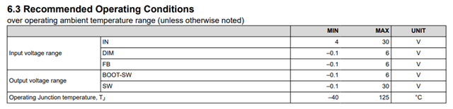

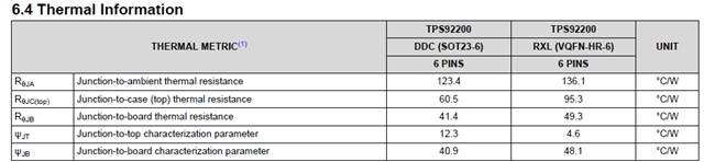

What's the TPS92200's maximum working Tc? Does it same as the Tj?
Assume IC power loss is 0.6W, Psi-JT is12.3C/W, so Tc is 12.3x0.6=7.38C lower than the Tj.
Tj max is 125C, then Tc max is 125-7.38=117.6C with 0.6W power loss.
