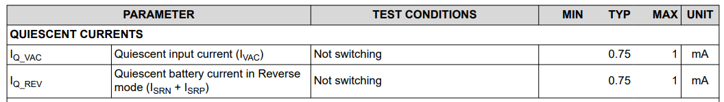

  4. 4.In ​​Constant Current (CC) mode​​, are the ​​charging current value​​ and the ​​maximum charging voltage​​ set by hardware design, or are they both configured via the ​​I2C​​ interface?
  5. 5.When the BQ25828 is not actively operating, does it have a ​​low-power mode​​ or ​​sleep mode​​? What is the ​​quiescent current​​ (in mA)? Which pin controls this mode?

    5. There is no sleep mode, but you can set EN_HIZ via I2C to turn off the REGN and stop switching. The datasheet lists the typical quiescent current as 0.75 mA and the maximum value as 1 mA.

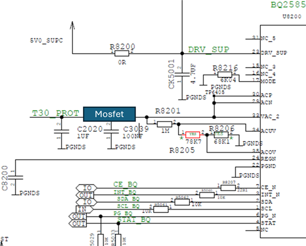

    Hi thanks for information.could you please help check the SCH applicaiotion for 12V/20A, only bulk mode.
    another question is the DRV_sup can use internal Voltage, just link directly connect to REGN pin?
    thanks.

  • Hi Frank,
    Thanks for working with this. I reviewed the schematic. Here are the notes:
    • The Coss of the MOSFET is too high. The BQ25856 datasheet has a section on power MOSFET selection that recommends the total switch node capacitance is less than 160/Vin (in nF). This is left out of the BQ25858 datasheet for some reason, but the information still applies. The MOSFET Coss here is 5.7 nF.
    • It would be helpful to place some ceramic (or other low ESR) capacitors close to the switching network on the T30 node
    This is correct. DRV_SUP can be from an external power supply. We also offer the REGN supply for DRV_SUP. When using REGN for the gate drive power, connect REGN directly to the DRV_SUP pin.

  • Hi, Michael
    thanks for feedback, for the typical quiescent current, if we add a mosfet on VAC pin to control VAC on/off,  could this reduce the quiescent current?
    when VAC off, how about the chip typical quiescent current?
    Best regards
    Frank zhang
  • Hi Frank,
    I think that the quiescent current would then depend on the MOSFET selection.

  • Hi Frank,
    The quiescent currents are the same:
    IQ_REV will the quiescent current when Vout is powered.
    Michael
