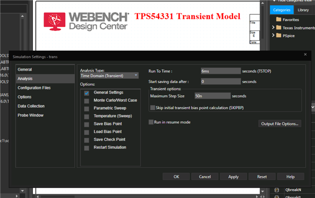

We recently using TPS54331 for designing 24V to 5V DC-DC converter. I try to simulate the Transient simulation in Altium Mixed Simulation, but it always fails.
I used the simulation model provide in TI website.
The error I encountered.
Error Simulation.nsx MixedSim  Transient Analysis: Time Step Too Small 12:18:53 04-09-2025    2
Error Simulation.nsx MixedSim  Simulation Failed                                     12:18:53 04-09-2025    3
  1. Did there is any proper simulation model for TPS54331?
  2. can success the simulation by altering the simulation parameters.
