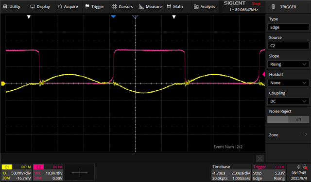

Have you tried your CLL resonant converter at a fixed frequency using a full-bridge with phase-shift modulation to regulate the output voltage?
    I can download the gerber files no problem after I logged in to my TI.com account. Please try to log in with your account before you try to download the files.
    No, I have never tried to do fixed frequency & phase-shift modulation control on a CLL converter. But basically doing so will turn it into a phase-shift full bridge converter (if we are using full bridge at the primary side).

    I already have a phase-shift full bridge with the CLL parts in it, designed to resonate at the switching frequency and the current in the primary is a sine wave!
    I am attaching a photo to show you.
