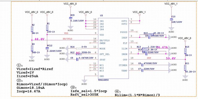

Plesae kindly review our schematic diagram for TPS16850, thanks.
Hi Zhang,
We will check and get back.
Kunal Goel
1. Mode pin should be open.
2. TVS diode recommended on VIN pin and schottky diode on output pin.
