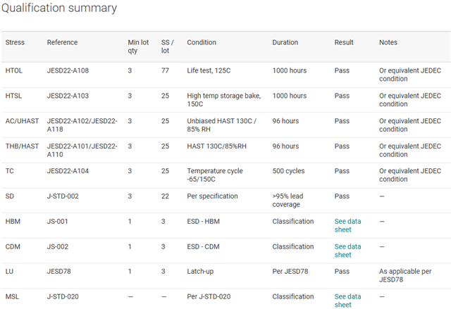

  • Hi C.Hari,
    TPS62291DRV has passed the following qualification tests which include biased and unbiased HAST as well as temp cycling.
    One cause for the leakages you observe on the output and input could be related to remaining flux after board assembly. Moisture may be helping the flux particles form leakage paths.
    My suggestion would be to run ultrasonic cleaning on the boards to make sure there is no remaining flux particles before the qualification tests
    Varun

  • Hi Hari,
    The 85% RH used is according to the corresponding JEDEC standard.
    I don't believe the higher RH of 95% used in your test is the reason. The qual tests run for this part at 85C were run at a much higher temperature (130C) and for a longer time duration (96 hours) compared to the test you mentioned. I would consider this as a more stressful qual for the device compared to the test you mentioned.
    Varun
