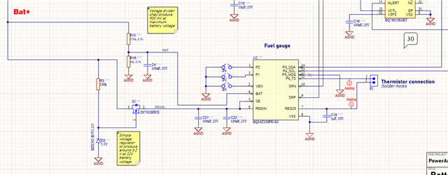

BQ34Z100: REGIN oscillating
Part Number: BQ34Z100
Is it normal for REGIN to oscillate? I see an oscillation with a period time of 425 ms on REGIN. It goes between voltage levels 3.5 to 4V and also before going up to 4V it has a short dip of 500 us down to 2V. I have the recommended mosfet setup with 10k and 2N7002 but with 5.1V zener instead of 5.6V. Is the zener voltage that critial?
