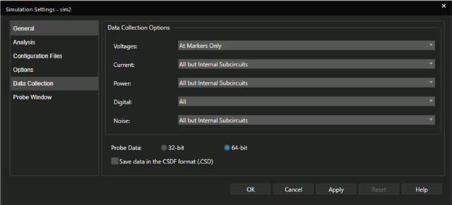

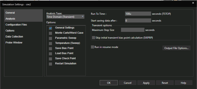

While simulating the TPS552892QWRYQRQ1 power management IC in PSpice for TI, the simulation ran for more than two hours and then stopped without displaying any graphs.

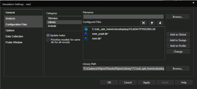

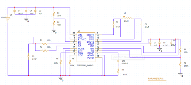

I’ve attached the schematics, simulation profile settings, and the output it shows when the simulation finishes.

    Please use this file to run TPS552892 simulation. And modify parameters in it. Don't recommend to create a new blank project to run it. Thanks.
    2821.slvme05.zip

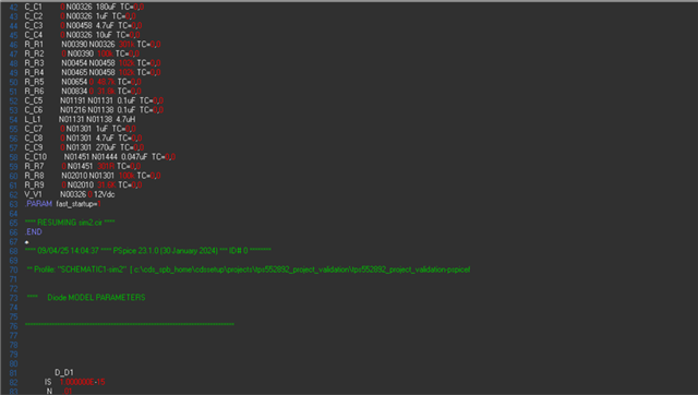

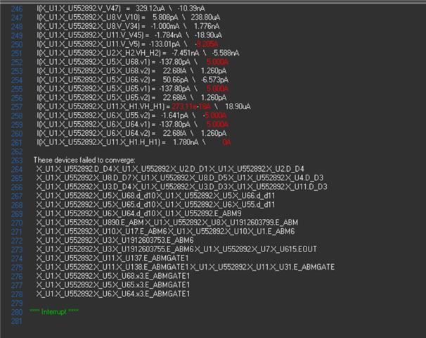

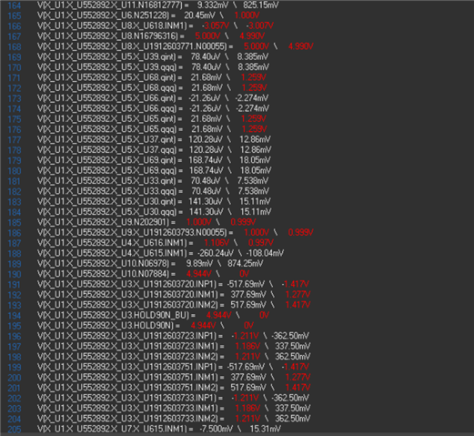

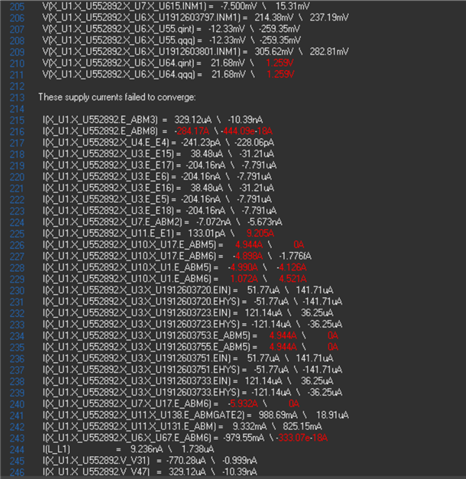

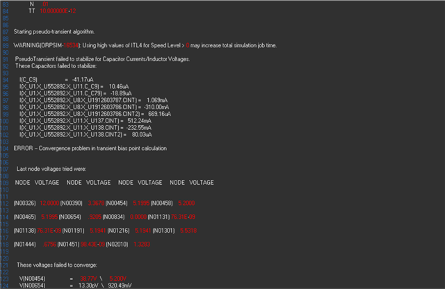

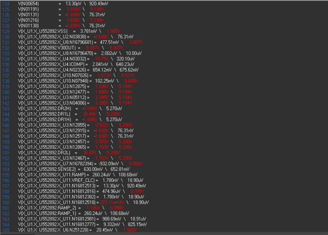

    The issue still persists. The simulation stops, and the configuration window for the simulation profile pops up. I can’t continue the simulation, even if I select Resume Simulation. Also is it normal that the simulation took more than 2 hours? (fast startup is set at 1000).
    this message shows up: These voltages failed to converge: V(N00390) = 1.011V \ 984.43mV V(N01444) = 1.334V \ 227.27mV V(X_U1.X_U552892.N298702) = 324.67mV \ 105.41mV V(X_U1.X_U552892.N82772) = 1.000V \ 324.67mV V(X_U1.X_U552892.CUR_AVG_MAX) = 241.40mV \ 78.38mV ERROR(ORPSIM-15661): 5 of 5 errors shown. See output file for complete list These supply currents failed to converge: I(X_U1.X_U552892.E_E6) = -527.05nA \ -171.11nA I(X_U1.X_U552892.E_ABM8) = -120.70A \ -39.19A I(X_U1.X_U552892.X_U883.E_ABMGATE) = -1.001nA \ -325.00pA I(X_U1.X_U552892.X_U4.E_E1) = -129.87uA \ -42.17uA I(X_U1.X_U552892.X_U4.E_E4) = 309.12nA \ 10.57nA ERROR(ORPSIM-15661): 5 of 261 errors shown. See output file for complete list ERROR(ORPSIM-15660): These devices failed to converge X_U1.X_U552892.X_U8.D_D8 X_U1.X_U552892.X_U4.D_D5 X_U1.X_U552892.X_U70.EHYS X_U1.X_U552892.X_U888.EHYS X_U1.X_U552892.X_U191.E_ABMGATE

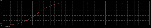

  • TPS552892_project_validation.ziphello,you can find the project file attached. the simulation works but for Vout is supposed to be 5V but in the simulation it shows that the ouput is 9V(the simulation profile used was sim3_1). Can you assist?
  • Hi Omar,
    I see you still create the project by yourself, it will be difficult for us to find the issue. Could you use the project I send? Do not create new project, just modify components in our example project.
