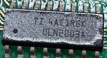

One of our customers having issue with ULN2003ADR2G.
  • Part Number: ULN2003ADR2G
  • Quantity Purchased: 430 pcs
  • Quantity Affected: 430 pcs
  • Date Code / Lot Number / Serial Number4AC1RGK
The customer has previously used the same part from a different lot without any issues (see attached photo for reference). However, the current lot is exhibiting abnormal behavior.
He has no issue using old lot#. (below Pic) But these.
1. Visual Inspection
There is no visible damage to the product. The issue was detected during electrical testing.
Additionally, we have received comments regarding differences in marking compared to the same product purchased through another supplier.
2. Discovery of Issue
The issue was identified during final electrical testing after product assembly, prior to shipment. See answer on #11.

8. Previous Usage
We have previously used the same product purchased from another supplier without any issues.

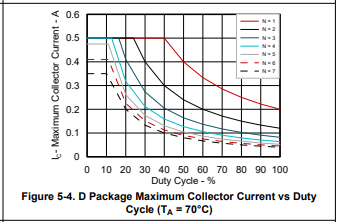

12. Over-Spec Operation
No over-spec conditions were present during operation.
