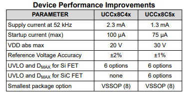

We are considering replacing the UCC28C43DR with the UCC28C53DR in our existing circuit.
Could you please explain the differences between these two parts?
Also, could you provide information on the advantages, disadvantages, and any potential issues when making this replacement?
Dice-K
    The differences are listed on the first page of UCC28C53DR datasheet.
    You can use either if the first page listed advantage does not seem affect your applications. But if you care, then the list gives what you asking.
