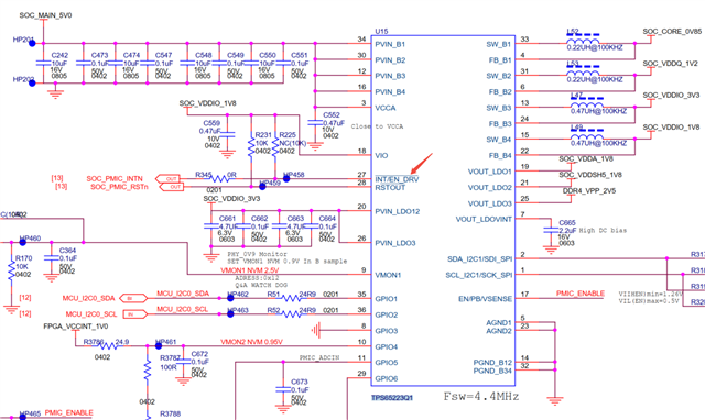

We use TPS65223Q1,and output voltage is OK,but the pin 27: INT/EN_DRV is low ,we have pull up at other side,could you guied why the pin 27 output low?
Thanks!

Hi Peter,
as we are discussing your custom design I would like to move this thread to the internal forums. Do you have a direct point of contact at TI who you can work with?
In general you have to clear all the interrupts for the nINT to go high but if it is configured as ENDRV then the MCU has to write it high.
