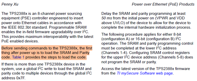

Regarding the TPS23881 startup procedure, according to the Application Brief How to Load TPS2388x SRAM and Parity Code Over I2C:
Regarding Highlight's question,
Does the firmware need to be written to the TPS23881's SRAM before each startup?
Or does it need to be written to the TPS23881's SRAM only during the first startup?
Unless the TPS23881 requires a firmware update, this step can be omitted.
  • Hello Kevin,
    Thank you for your question. The SRAM must be programmed via I2C every time TPS23881 is powered on. Any other I2C commands (unrelated to SRAM programming) must wait until the SRAM programming has been completed. Please let me know if there are any further questions!
