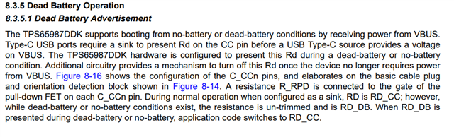

  • TPS65987DDK has a built in Rd resistor which is always active when there is no VIN3V3 supply.

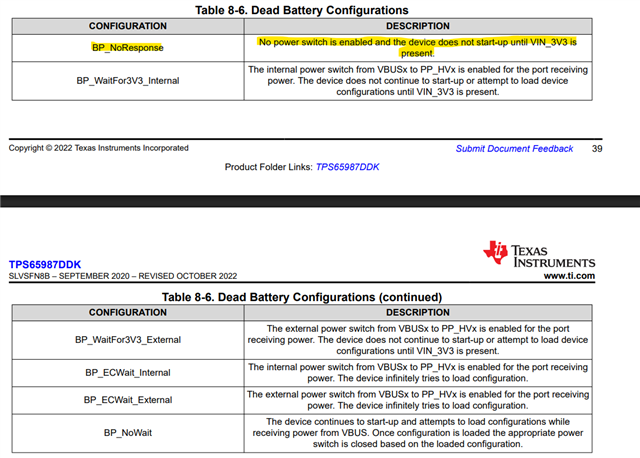

  • Hi Ryuuichi,
    1- See Dead Battery Operation section in the datasheet on Rd presence on CC pin.
    The power path behavior is dictated by the dead battery configuration set. The power path remains disabled until VIN3V3 is present in BP_NoResponse configuration (see below).

  • Hi Ryuuichi,
    When the dead battery configuration is set to "BP_NoResponse", no power path will be enabled. Once VIN3V3 is present in the system, and the dead-battery flag is cleared, the device will then proceed with normal operation and become the power Source.

  • Hi Ryuuichi,
    During dead-battery, the PD is powered from VBUS at 5V only as this would be a Type-C implicit contract, no PD contract.
    Once the configuration is loaded, since the PD is configured as a source-only, the PD will not be able to Request PDOs from the Source.
    Therefore, once VIN3V3 is available, the MCU will need to clear the dead battery flag so that the PD can begin advertising its Sourcing capabilities.
