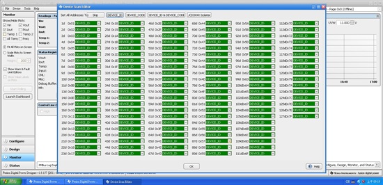

I use the UCD9224 EVM Board and usb adapter and I connect the adapter and 12Vin to the EVMboard.But suddenly  i can not enter the GUI online mode.What should i check?

    I don't kown what your mean. I try  Texas Instruments Fusion Digital Power Designer (offline)-->open sample project-->UCD30xx isolated digital power controllers-->file-->preferences-->configure device scan mode and address-->device ID . show the following.
