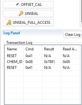

I followed the instructions in SLUA925 (How to complete a successful Learning Cycle). According to BQStudio, All looked good! Below is a BQStudio clip after the second complete discharge.

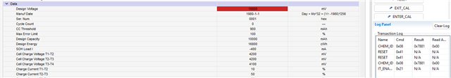

Below is the Ra table. It looks as though it updated as well.

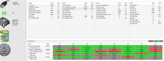

Yet "Learned status" is still 4 on the BQStudio window and at State:Status Update = 00
Any guidance would be greatly appreciated.
