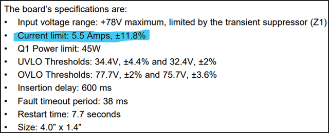

I bought the LM5069EVB for LED tube control
we need the max power is 300w, but 230w limit
may i know which parameter need be adjust?

Thanks for reaching out.
The EVM is designed for 5.5A typical current limit. This can't be adjusted in this board.
It's increased by reducing the value of the current sense resistance. But in this board the current sense resistance cannot be further decreased. This will violate the MOSFET SOA margin, which can damage the MOSFET during power up into short and output hot short events.
