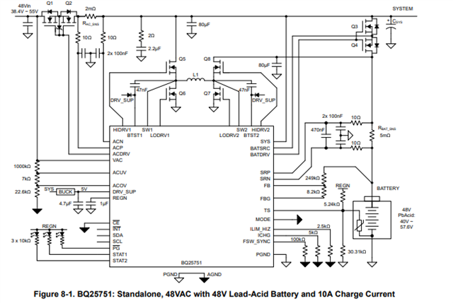

Q1.
The schematic in the parts calculation tool you sent me doesn't has terminals of BATDRV(No.15, Output), BATSRC(No.16, Input),
ACDRV(No.31, Output), SYS(No.32, Input) because power path is not implemented.
Could you tell me how to handle there unused terminals?
Q2.
If the handling ways of terminals in Q1 are described in BQ25751 datasheet, could you please tell me the page or section number.?
Q3.
Could you please tell me how to chose MOSFET, Q1~Q4 of Figure 8-1 schematic to implement power path.
