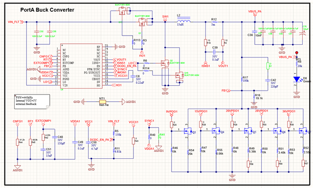

LM5148: Use LM5148 to have a PD board design, need to change 48V to 5V,9V,15V,20V,28V,36V, but the output can't go to 15V.
Part Number: LM5148
Hi Team,
I use the LM5148 to finish the 48V to 5V,9V,15V,20V,28V,36V transfer, but the output can't go to 15V. When I short the SYNC to GND to use the FPWM, the output can go to 15V, but the power loss too high, about 48V@0.3A in no load, seems to work in some abnormal condition, could you please help me to check it? Thank you.
(The SW pin, it’s my fault, I have used one line to connect to SW1 now.)
Kunyue
