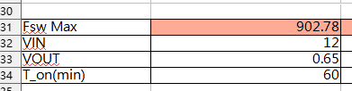

As shown in the figure below, under the following conditions the TPS563257’s estimated maximum switching frequency is around 900 kHz.
So will the TPS563257 automatically reduce its operating frequency from 1.4 MHz to about 900 kHz?
Or it not impact by Vin/Vout ratio, always keep Switching frequecy ~1.4Mhz?
