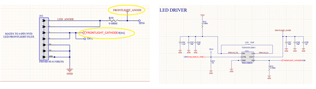

TPS61158: Request for ESD Diode Rating Recommendation – TPS61158DRVR Frontlight Lines
Part Number: TPS61158
We’ve observed that the FRONTLIGHT_CATHODE line currently lacks ESD protection, and while the FRONTLIGHT_ANODE line includes a 1µF capacitor, we believe additional ESD protection is necessary at both ends.
Could you please recommend suitable ESD diode ratings for both the anode and cathode lines, considering the frontlight driver IC in use is TPS61158DRVR?
We’d appreciate guidance on:
  • Recommended working and clamping voltages
  • Unidirectional vs. bidirectional diode preference
  • Any specific part numbers or footprint constraints to consider
Looking forward to your suggestions.
