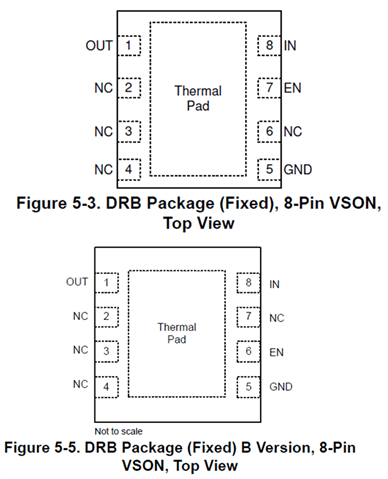

Since there are two package, my customer want to make schematic as 6pin&7pin EN. Is it okay to apply 5v both 6pin and 7pin?

Hey Youhei.
Yes, you can apply 5V to pins 6 and 7. They are not internally connected.
