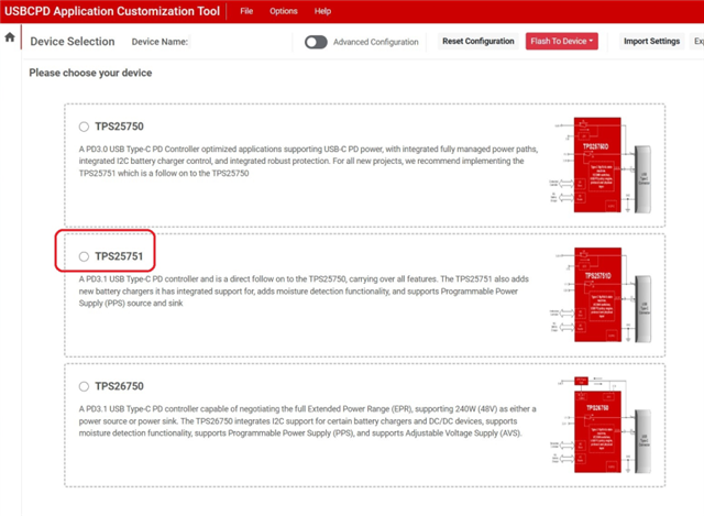

A follow-up to a related question. I would like to confirm the following points regarding the standalone operation of TPS25751S:

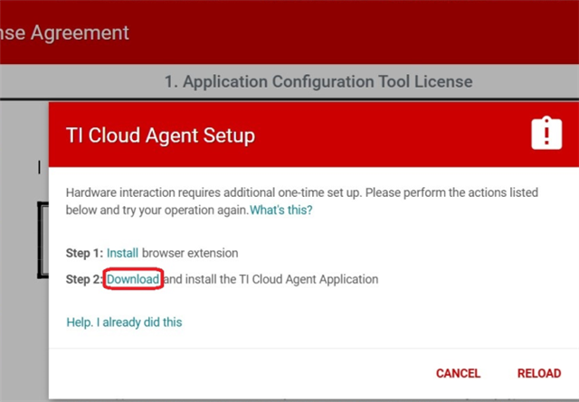

  1. USBCPD Application Customization Tool usage
    • In Image 1, there is a "DOWNLOAD (TI Cloud Agent Setup)" option. Is this required even when we only need to generate a bin file, or is it only necessary when flashing directly to the device?
  2. Configuration steps

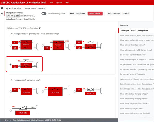

    • Select TPS25751 (Image 2)
    • Choose the TPS25751S configuration (Image 3)

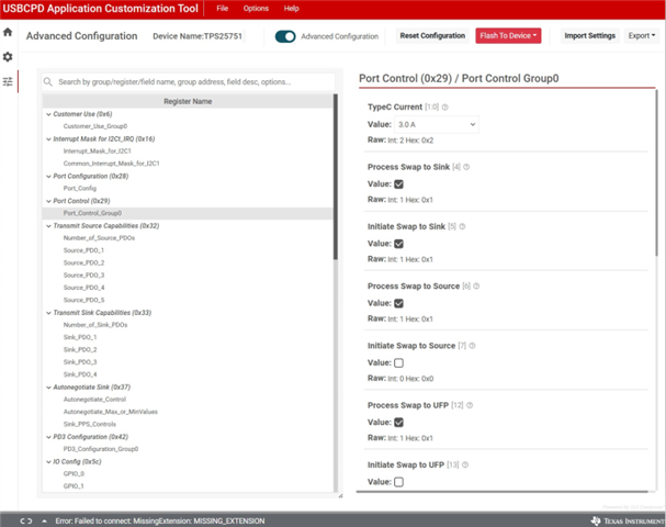

    • Enable Advanced Configuration (Image 4) and set:
      • Source PDO: one entry (5V/3A)
      • Add Sink PDOs if needed
      • Enable DRP/DRD and define GPIO assignment
    Could you confirm if this procedure is correct? Are there any other mandatory configuration items we should set?
    In order to use the Application Tool, you need to download the TI Cloud Agent.
    Confirm that all of the questionnaire is filled in. Once this is done you may go into advance configuration and change induvial registers accordingly.
