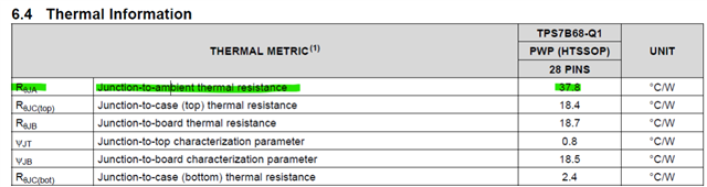

1. What is Junction-to-ambient thermal resistance (2p2s) ?
 - The datasheet only lists the junction to ambient thermal resistance for a PCB 1s test board. Is there any information available for PCB 2p2s condition?

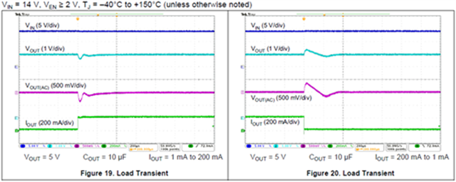

2. What is the load transient time when Iout changes from 1mA to 500mA?
 - The datasheet only provides information for the 1mA to 200mA condition.
