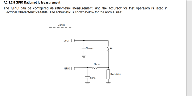

Are there any settling or waiting times  in case we change GPIO configuration from ratio metric to absolute and vice versa?
When we would measure with a GPIO TSRef we could use ratio metric to evaluate GPIO voltage:
U_GPIO = ratio_GPIO * U_GPIO_TSREF
Is it recommended to multiply ratio metric value and TSRef voltage  to get GPIO voltage?

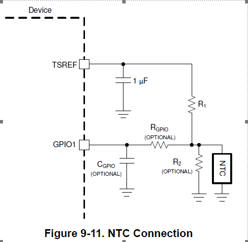

  • Hi Friedrich,
    1. After changing the GPIO configuration, one would need to re-enable adc_go to set the GPIO to the correct configuration. The waiting time would be the adc_cycle needed for the GPIO values to update.
    2. The ratiometric value from the GPIO registers is dependent on customer board's resistor setup, an example can be seen below on circuitry
    John

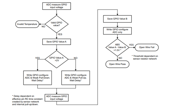

  • Can you show me a abstract sequence to measure temperature and diagnose GPIOs?
  • Hi Friedrich,
    Regarding OPNWR/ADJSHRT diagnostics, there are procedures in the functional safety guide in secure resources.
    Regarding measuring temperature, it would be dependent on the ntc resistor
    assuming there are no optional resistors, the calculation would be NTC/(R1+NTC) * TSREF = GPIO1. Then the value for NTC can be calculated and thus the temperature.
    John

  • Hi Friedrich,
    The TSREF is assumed to be stable, as an unstable TSREF will cause inaccuracy in certain ADCs.
    In SMs, it is advised to test with Absolute Values, however it will also be fine to use Ratiometric to be translated to absolute given SW translation to Absolute is accurate.
    John

  • Hi Friedrich,
    Let me get back to you regarding steps on how to check GPIO OW with ratiometric after checking with functional safety team. Both ratiometric and absolute measurements are both able to do GPIO OW/ADJSHRT functionally safe. In theory, the absolute - ratio conversion can be determined if you have one or the other either that be the adc reading or the threshold in OPNWR and ADJSHRT.
    John
