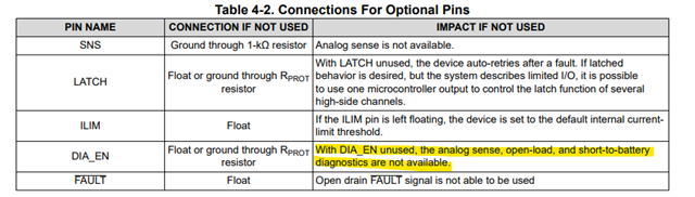

My customer want to set DIAG_EN open to achieve low quiescent current.
In this situation, current sense function will work or not?

Hey Youhei,
Yes, your understanding is correct. With DIAG_EN low current sense is not available.
