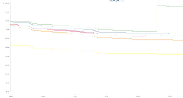

BQ34Z100-G1: BQ34Z100 SoC jump
Part Number: BQ34Z100-G1
Other Parts Discussed in Thread: BQ34Z100, GPCRA0, BQSTUDIO
I am using the BQ34Z100 to evaluate the SoC of our 8s2p LiFePO4 batteries. The problem is that during operation over several days, sudden jumps in SoC occur (for example, going from 60% to 80% or from 40% to 7%). I am unable to understand the reasons behind these jumps. The system operates during the day and stays in relaxation mode all night, so the coulomb counter correction should happen every evening, with a daily correction that should not allow such jumps.
