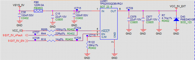

Hi team:
       we have a question when we use the part TPS2553, especially for the input and output capacitance value for choose.
       our schematic diagram as follows:
      background:
       the load the output of TPS2553 is 60mA at max value(when power up). normal load is 30mA。
      question:
       we think the output and input capacitance is a little big, can we use a smaller one?
       we want to know what should be the smallest value of the input and output capacitance? is there any document theory can share with us?
