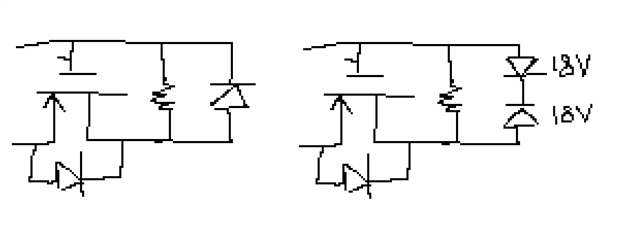

    I have just updated Jiaqi regarding this question. I believe what may be occurring is that your CHG FET is off when your charging is occurring. Currently, you have the diode protection for your CHG FET as shown on the left. Try adding another diode and let me know if this fixes your issue when charging with 60V. This is shown on the right.

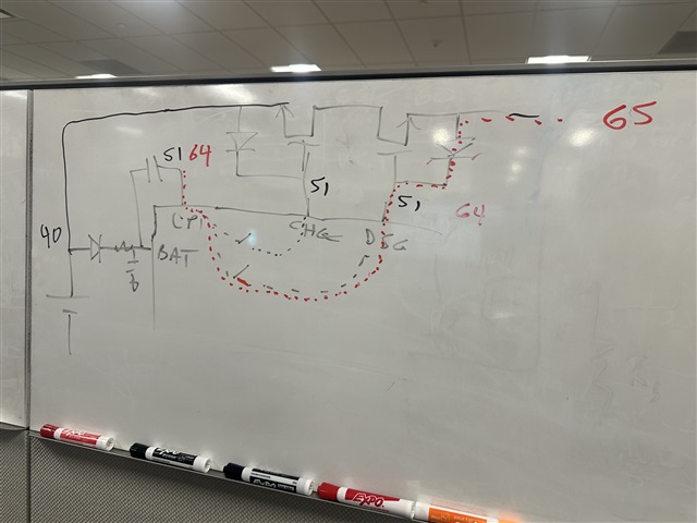

    The test procedure is as follows: 1. The BMS enters a sleep state, and the total voltage of the cells is 40V. The external charger sets the voltage at 65V, resulting in the voltage at the Pack end being 25V higher than the total voltage of the cells.
    2. We have added a logic for not charging when the pressure difference is too large. When the pressure difference exceeds 25V, the charging mosfet of the BMS board will not be opened, but the voltage of the charge pump will rise from 11V to around 20V. The discharge MOS gate will gradually generate a driving voltage of about 3V. A driving voltage of 3V will cause the MOS transistor to be in an incompletely conducting state. A pressure difference of 20V will result in a transient current of 600A. Under the condition that the MOS transistor is incompletely conducting, the MOS transistor will be damaged.
    The issue that needs to be addressed now is: why does the charge pump voltage rise when there is a 20V pressure difference between the pack  and the Bat ? Why does the charging MOS have a gradually increasing voltage of Vgs?
    As shown in the above figure, it should be to clamp the driving voltage with positive or negative voltages. However, this cannot solve the problem we are currently facing.
    Looking forward to your reply. thanks.

    I think the following image might better explain what is occurring:
    Does this make sense?
    Rohin Nair
  • I think I can understand why the damage occurred, but I still don't have a strategy on what to do. How can we prevent the voltage of CP1 from rising now? When the CP1 voltage rises, why does it cause the charging MOSFET to have a Vgs voltage? Could you please clarify exactly what we need to do? We can take the time to verify it.
    Thanks Very much.
  • Hello Gaojie,
    Adding another diode in reverse as shown above should prevent the CP1 from rising. Can you try adding this and see if this issue still occurs?
    Rohin Nair
  • I'm very sorry for the late reply.
    We have tried the two solutions as shown in the picture above. Solution A failed to solve the problem, but Solution B did.
    What we are most concerned about is the issue with solution B. As shown in Solution B, we added a voltage stabilizing diode, but the voltage stabilizing diode has leakage current. Will this cause the CP1 capacitor to fail to work properly? Additionally, during the short-circuit test of P+/P-, a large surge voltage will be generated. Will this possibly cause damage to the CP1 capacitor?
    Looking forward to your reply very much.
    Thanks.
  • Hello Gaojie,
    Since the diode goes back before D8, this may be dangerous for short circuit discharge. If the stack voltage dropped due to SCD, then channel 16 would drop, but the BAT pin would remain high. This might cause the diode to start conducting and pull down CP1. It would be better to connect the diode across the CP1 cap, between CP1 and BAT.
