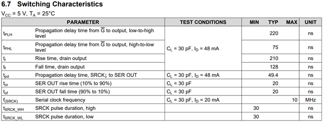

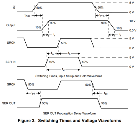

  • Hello Ryu,
    Are you referring to output drain voltage undershoot? I see the rise(tr) and fall(tf) time are noted as 210ns and 128ns respectively. This is time to reach 90% or 10% of the expected voltage during a transition. Is the undershoot during this period?
    Could you be more specific on which signal or show the waveform? I don't have specific information on voltage undershooting but it can be sampled on an EVM if needed.
    For typical switching waveforms see the images below:
    Isaiah

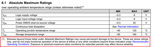

  • Hi Ryu,
    The only guidance we can provide on violating abs max ratings is the footnote (1) from table 6.1 in the datasheet. We cannot provide guidance on the exact time duration that will cause damage or not.
    Isaiah recommended measuring with a tip and barrel probe to be sure that the undershoot is real, and not an artifact caused by the ground loop in a traditional scope probe. You can also check your probe compensation to see if the probe itself exhibits undershoot/overshoot behavior.
    https://resources.pcb.cadence.com/blog/what-is-oscilloscope-probe-compensation
    If you can measure with a tip and barrel probe to determine the undershoot is real, I recommend following Isaiah's suggestion to include some series resistance on the digital line to reduce the undershoot.
