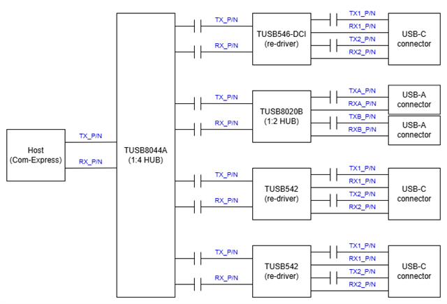

I'm implementing the following architecture:
USB 3.X Host (COM-Express) <--> one USB 3.X bus <--> (upstream) TUSB8044A (downstream) <--> four USB 3.X buses [...]
The four TUSB8044A downstream buses are routed as follows:
  • Downstream bus #1: routed to TUSB546-DCI and then to USB-C connector
  • Downstream bus #2: routed to TUSB8020B and then to two USB-A connectors
  • Downstream bus #3: routed to TUSB542 and then to USB-C connector
I wonder where to place the AC coupling capacitors on the SuperSpeed USB signals. Reading the TI component datasheets, so far I placed them as follows:
  • 1x100nF series capacitor on each TX signal between the USB connector and the re-driver (TUSB546-DCI/TUSB542, for USB-C connectors) or the TUSB8020B (for USB-A connectors)
  • 1x100nF series capacitor on each RX/TX signal between the re-driver/the TUSB8020B and the TUSB8044A
  • No capacitor on the updstream side of TUSB8044A
Could you guide me through this, are these capacitors positioned correctly?
