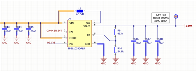

    the board is supplied from an external DC power supply with the mentioned voltage from above (3.3V)
    Due to our company restrictions i can only provide you a snippet of our schematic.
    Our problem is not the efficiency. Our main problem is, that 10% of the whole produced boards have a completely different current consumptions.
    As mentioned above the main problem ist that we are expecting that every board should run in the forced pwm mode. But it seems that 10% run in the auto FPWM mode?
    This makes us uncertain whether we can install these assemblies without concerns.

  • Hi Lukas,
    Can you give me some test waveforms of the wrong board? I want to see the start-up waveform include Vin, Vout, SW and MODE. Looking forward to your reply. Thanks.
