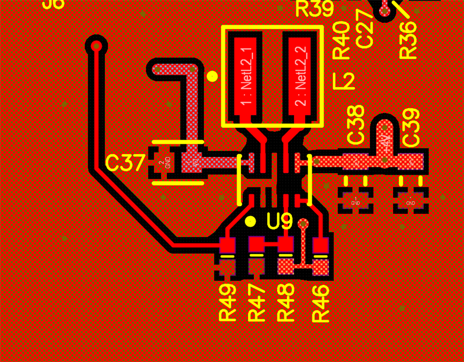

A regulator is built using TPS63802DLAR. It takes the power (VD on schematic) from a single Li-Ion cell and converts it to 4V. A typical load current is 300-500mA with very short bursts up to 1A. The enable signal is 0V/2.5V. About 1000 boards were built, and so far two parts failed after several months. Once failed, they take sink about 100mA from the power source even with the enable pin at 0V. The enable function still works, i.e. there is 4V on the output with enable pin high and 0V with enable low. I am attaching the schematic and the layout. The PCB has four layers with a massive ground pour on the top and bottom plus the ground plane with frequent vias, so the part doesn't get hot.

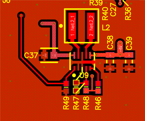

    • No concern on the schematic. But for the layout, the major one that should to be improved is that connect the GND pin and the Cout GND at the same layer. And also, the input cap and output cap can be adjusted to put more close to the chip.
    • You may refer to the following layout example.
    Lei

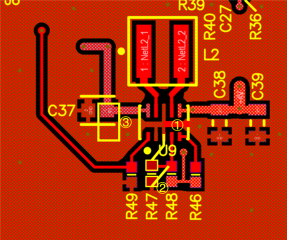

    Except the GND trace, I also noticed that the feedback GND (R47) is not good. In current version it's simply connected to the GND plane, so the feedback GND may be noisy. If there is a chance to optimize the layout, please don't forget here. Following is an example: rotate the R47, connect the R47 GND to the GND pin with a separate GND trace.

    From the measured data, the concern is in the low spike of -3.188V. I think it can also be reduced by the layout optimization.
    Regarding the layout optimization, there are three items total, shown below:
    1. GND trace
    2. FB GND
    3. Cin position
    The most critical item is the first one: GND trace.
    Before the formal layout update, you may have a quick check first: scrape out the solder mask layer and connect the GND (shown in ①) by solder, and then check whether the low spike is reduced.
