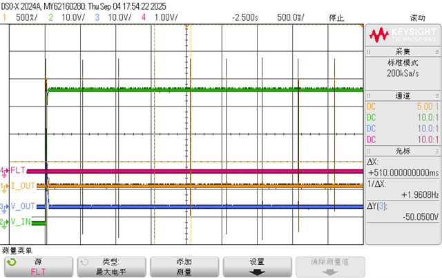

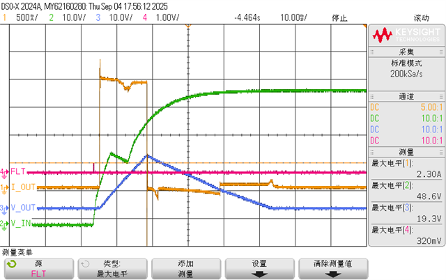

Customer use TPS2660 with an super capacitor application, 3mF Cload, so the surge current will exceed the maximum value that the OCP can be set to, causing the device to repeatedly restart.

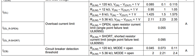

2.23A/2.21A is not enough, customer needs 3A OCP(rated current 1.5A) after evaluation.
Do you have any suggestions for such application?
  1. Add soft-start circuit? Resistor.

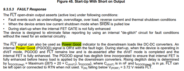

  2. Whether OCP can be disable in the start-up state?
  3. Whether OCP can be set 3A, exceed the recommend value?
  4. Or this device is not suitable for super capacitor application? Any other choices here?
