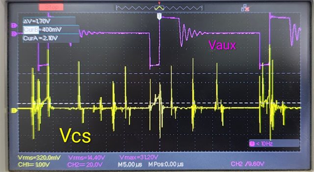

Problem 3:
  • After modifying the CS pin divider, the IC kept restarting, so I checked the CS waveform (attached).

Current Status
  • Unfortunately, one IC was damaged while I was measuring voltage at the VS pin.
  • Although I did not short it, the multimeter probe introduced noise which caused the IC to fail.
  • So far, I have lost five ICs this way. I am waiting for replacement ICs to continue testing.

    1. Why the VS pin is so sensitive to nearby objects/noise, and whether this is normal or a layout-related issue.
      • The VS pin is used to regulate the output voltage during the transformer demagnetizing time (tDmag). It is also used to check the input voltage when the primary FET is on.  So, if there is noise on this pin it will react to it.
      • During tDmag I a see there is a lot of ringing after the leakage spike. This can lead to issue with accidently triggering OVP.
    2. How to stabilize operation and avoid continuous restarts.
      • If your design it restarting it is most likely due to an OVP, OCP or input UVLO fault. The most common issues for this is noise.  The following link will bring you to an application note that discusses how primary fault sensing that the UCC28711 uses.  The issues with it and how to resolve them with filtering, snubbing and clamping.  https://www.ti.com/lit/pdf/sluaac5
      • The high side resistor in your VS divider to the resistor sets the input voltage where the design turns on. It sounds like that is not setup correctly.  The excel tool mentioned earlier can be used to select the resistor to turn on at the proper input voltage.
