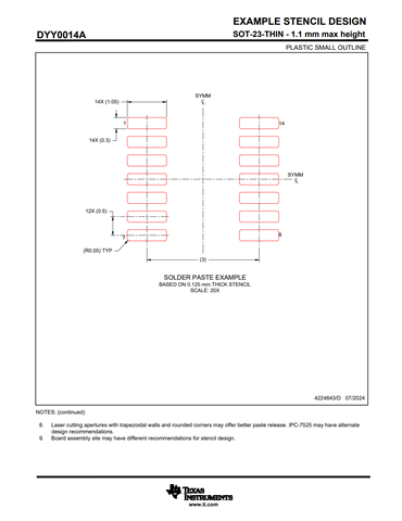

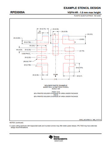

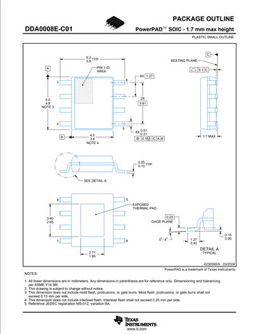

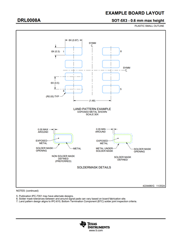

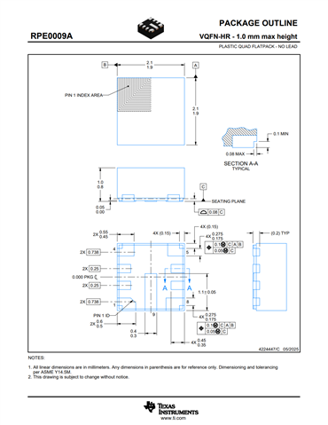

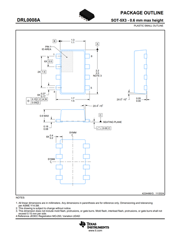

    The diagram may be found at the end of the respective datasheets, and that will be the best source for those diagrams. However, I've posted screenshots and links below. Note the package designation in the upper left of the pages.

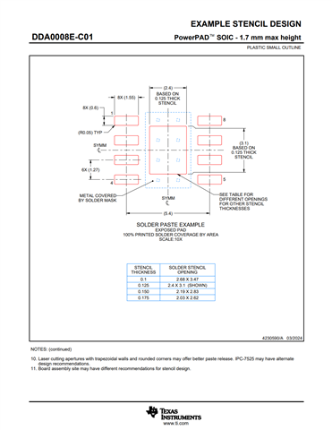

    TPS7B8633QDDARQ1 (TPS7B86-Q1 DDA package):

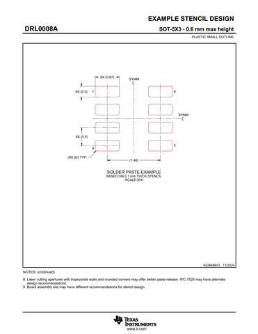

    TPS628501QDRLRQ1 (TPS628501-Q1 DRL package):

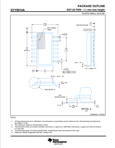

    TPS37AC465A7DYYRQ1 (TPS37-Q1 DYY package):

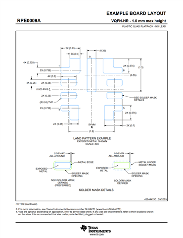

    LMR43620MSC5RPERQ1 (LMR43620-Q1 RPE package):
