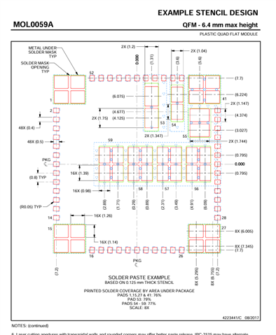

We had used the power module IC TPSM846C23MOLR in my board. We had followed the stencil design as provided in IC datasheet as mentioned

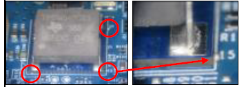

During the assembly process, after assembling the components, small solder balls are coming near the corners of the IC. In almost all of our boards, we are facing the same solder balls near the IC.

    We haven't had issues with the DS published stencil, typically that is what we use on our EVMs with no issue.
    However you can request you CM to reduce the aperture to ~90-95% on their side, you can also request corner pads only since that is where you are seeing issues.
    There's a variety of reasons for solder balls like:
    -Mounting pressure been to high
    -Soldering temp
    -moisture
    -contamination, etc

    Yes I can help clarify. The solder balls you are seeing can be caused by a many reasons. You can have the contract manufacture reduce the stencil aperture/opening for the corners you're seeing an issue on which based on your previous message, it looks like the pins in the corners so pin 1, 15, 27, 41. The current stencil is at 100% since that is the original, you can check and see if they can maybe reduce the stencil size for those pins to maybe 90% so make them a bit smaller. You could also have them put less pressure on the IC, or use less paste volume, that could all help too.
    I would suggest also making sure that reflow is following MSL rating/Peak reflow at the end of the datasheet "Level-3-260C-168 HR", this essentially means that the device has moisture sensitivity of level 3 so part can absorb moisture from air once package is opened, part must be reflowed within 168 hours since package is opened and exposed to air else you have to bake it, and max temp of 260C that device is rated for reflow soldering process, per JEDEC standards.

    Can you confirm whether to reduce aperture size near the corner edges of the pad or reduce the size between those 4 squares.
    Abhishek
  • Hi Abhishek,
    You can try reduce aperture size near the corner edges of the pad.
