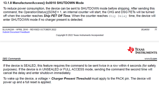

Is there an estimated time for BQ4050 to respond the command?
Because sometimes the customer will send three times shutdown command and then BQ4050 could enter shutdown mode under unsealed.
I am thinking it may be because of the time interval between the first and second command is too short.
